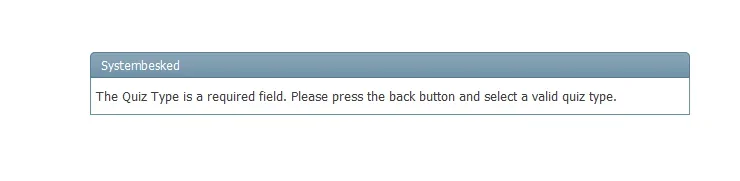

I have allowed members to create quizzes but they get this error when trying to:
Where do I change that in setting please?
There is a problem on the results page display. The quiz is scored correctly but it doesn't display right on that page. I'm working on fixing it.
On the quiz submit error, you need to give the usergroups permissions to the types of quizzes you want to let them create.
ACP->DBTech-vBQuiz->Quiz Type Management
Click the Modify for each type you want them to be able to submit and select the usergroups and save.
