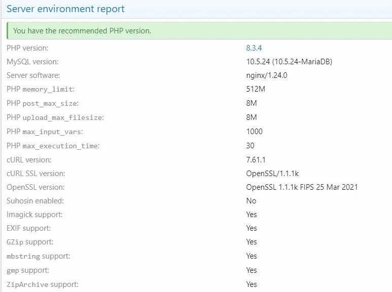

Hi, I wonder if someone can help. I'm running PHP 8.3.4 (Tried 8.1 ansd 8.2 also)
If I turn on Dragon byte mail and do a refresh, I get. "GuzzleHttp\Psr7\Uri::getScheme() must be compatible with Psr\Http\Message\UriInterface::getScheme()"

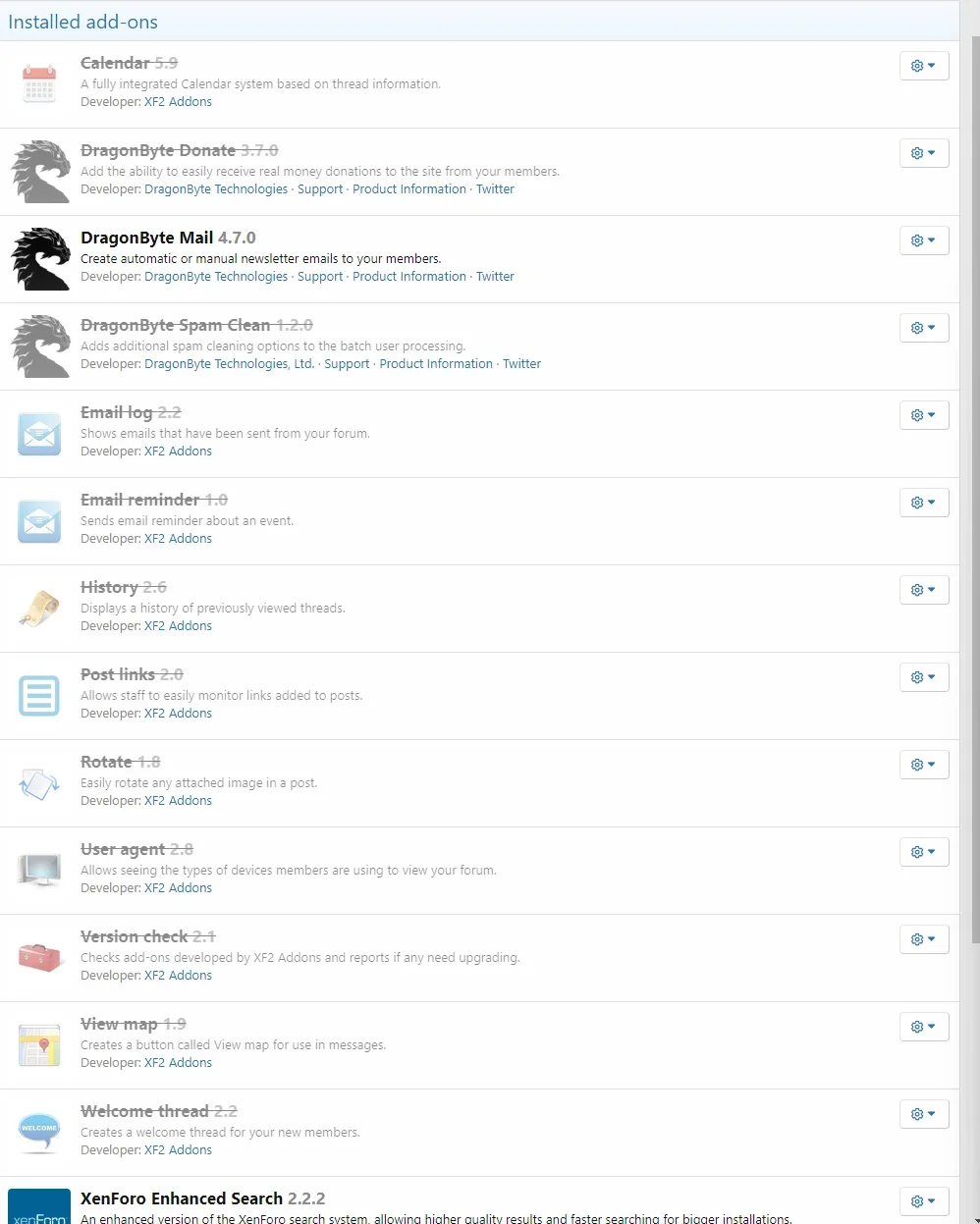

I think you could be on to something there. Disabling all XF2 Addons also makes the issue dissapear.
I'll do more digging into this to find which one triggers the issue.
Thanks
Re-enabling the add ons I dont see the Guzzle issue anymore.

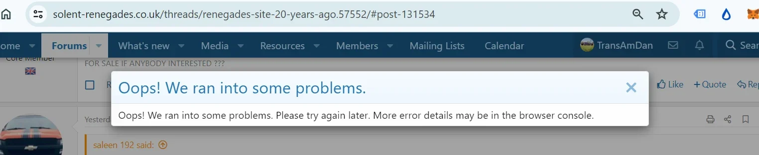

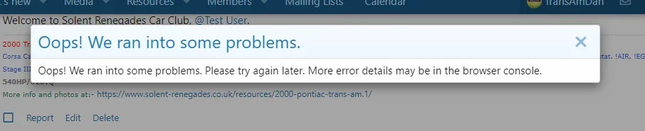

If I reply to a forum post I get a pop up message. Could be one of the other add-on causing this which combined with DragonByte Mail. If I disable DragonByte Mail, or all the other XF2 addons then this message dosn't appear.
Okay I'm getting somewhere although not the original problem. But with all Add-ons turned off.
The I reply to a post I get this error.
I then turn off DragoneByte Mail, I can then post fine.

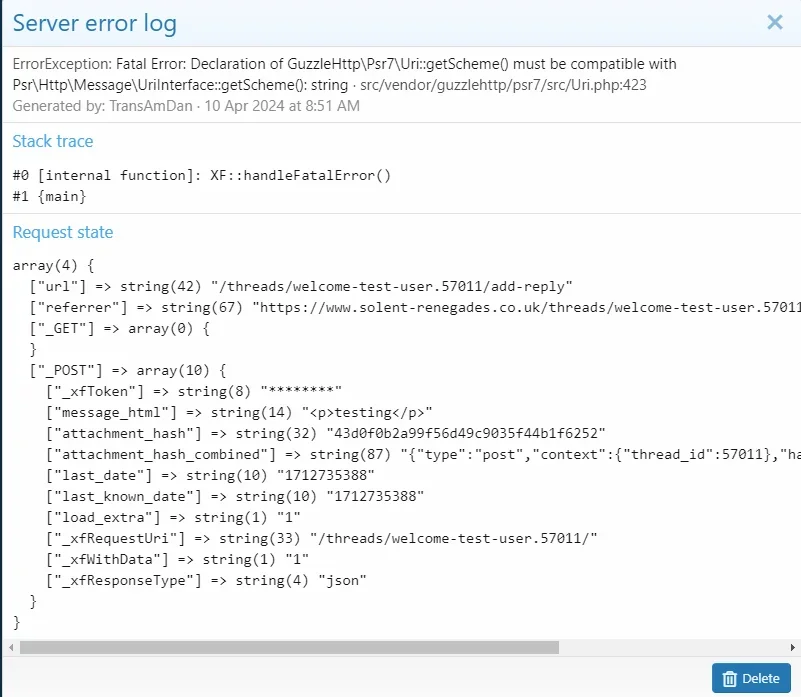

During the time DragonByte was on, some logs were recorded.
So it seems DragonByte Mail dosn't like something on the server, perhaps something needs updating. It is a new server, and I do have SSH access to install/update things. At present I'm dont know what might need updating.

This addon is incompatible with guzzlehttp/psr7 privided by xenforo
FastCGI sent in stderr: "PHP message: PHP Fatal error: Declaration of GuzzleHttp\Psr7\Uri::getScheme() must be compatible with Psr\Http\Message\UriInterface::getScheme(): string

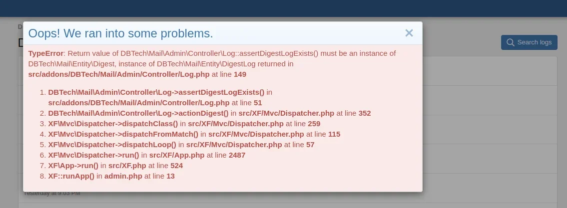

Also when i click a digest log i get this error (did not happen with 4.6.0 also)

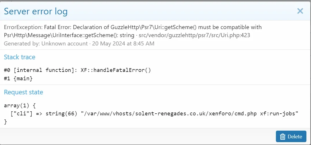

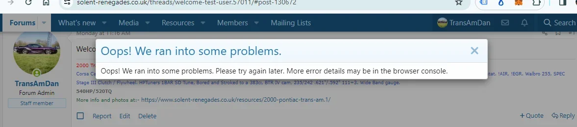

To create the error
With DragonbyteMall add on enabled, and I go to post a forum post. Any thread, just replying. I get the following.
This is logged in the Server Error log.

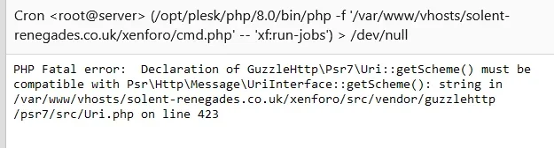

Also it appears to create an error in the Cron job. (server reports cron job errors by email)
