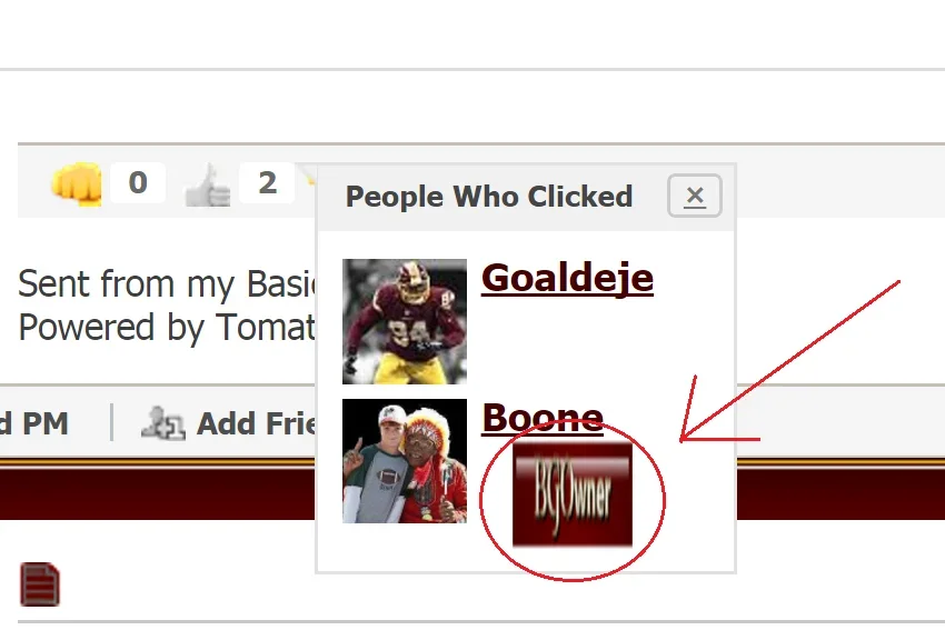

Thanks Fillip H., I reinstalled everything and I was able to figure it all out and get it setup the way I wanted. Couple quick questions:
1) When I click the # of 'Likes' or 'Thanks' at the bottom of the post where I have it displayed, I see it pulls up the member's avatar and username. But for some of my staff who have custom user titles including a graphic, it's pulling that too and compressing it (image attached). How can I edit that code to have it only display username and avatar?
2) I set up a forum side block to show up to 5 'Thanks', 'Likes', etc... I use the ESB (Everywhere Side Bar) mod. I think I have it set up correctly in ESB and forum blocks but no sidebar block is showing. Am I missing something?
Thanks for any guidance on those two points.
Cheers,
John
1) How can I edit that code to have it only display username and avatar?
Unfortunately this cannot be edited, sorry :(
